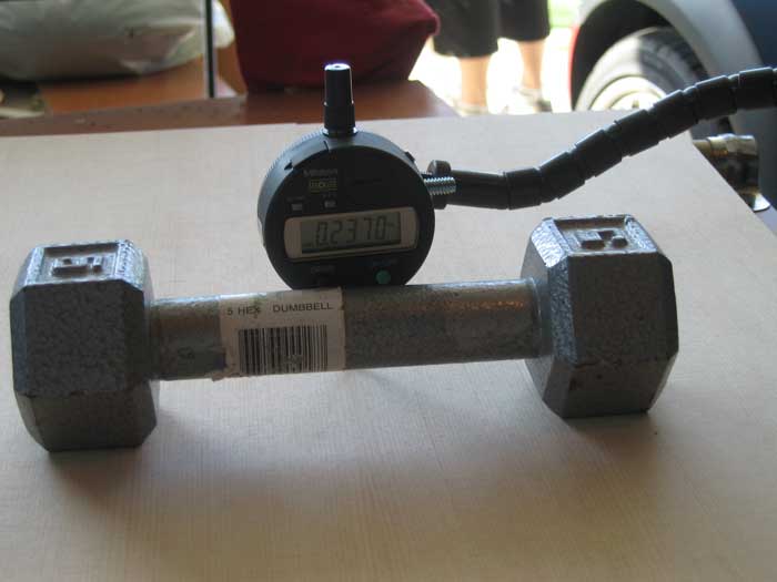

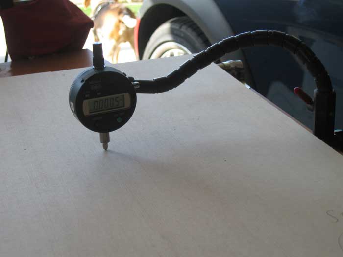

PostPosted: Mon Jan 07, 2008 2:25 pm
Here are the only picts I could find. It would be better if my weight was a bar to evenly distribute the weight, but I have been using this so far and my results are fine.
Numbers for the deflection are kind of meaningless taken out of context of the entire system and bracing etc. For what it is worth, here is some data on my L-OO

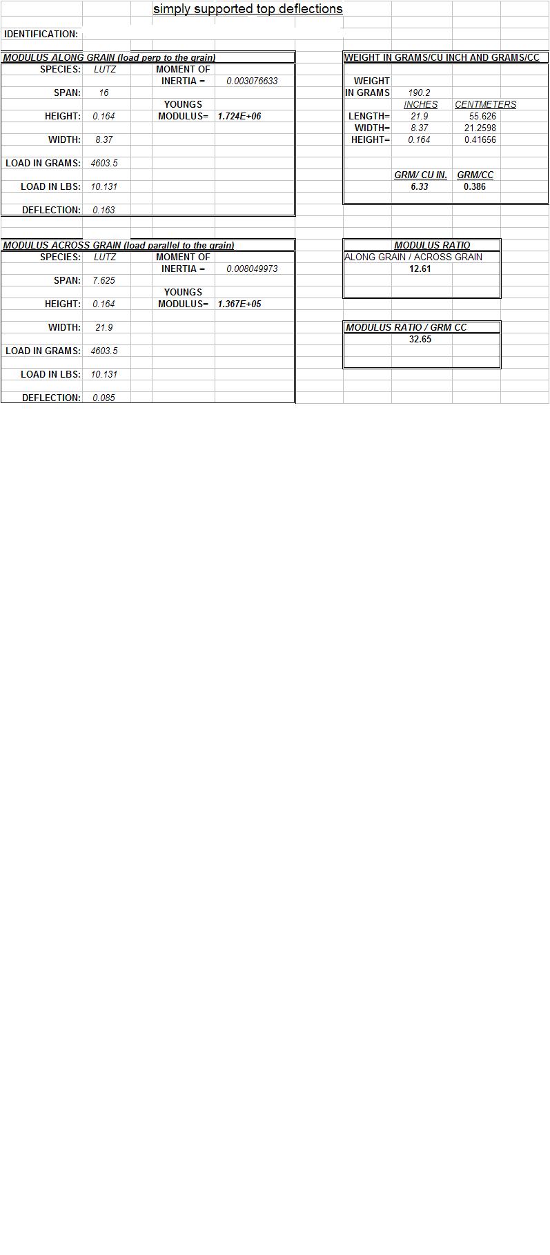

Here's a sample of the way I keep my data and what I check.
My weights a little heavy in this sample. I think about half of it is about right.
As you can see I just set up a standard spread sheet and track my data that way.
